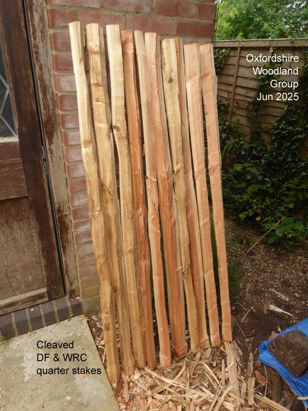

A dead hedge really needs decent stakes to support and hold the hedge in place and so quartered (cleaved or sawn) DF / WRC / EL /SC / OK would be ideal.
The dead hedge will likely be topped up year after year and so non durable hazel stakes would not be a good choice.
