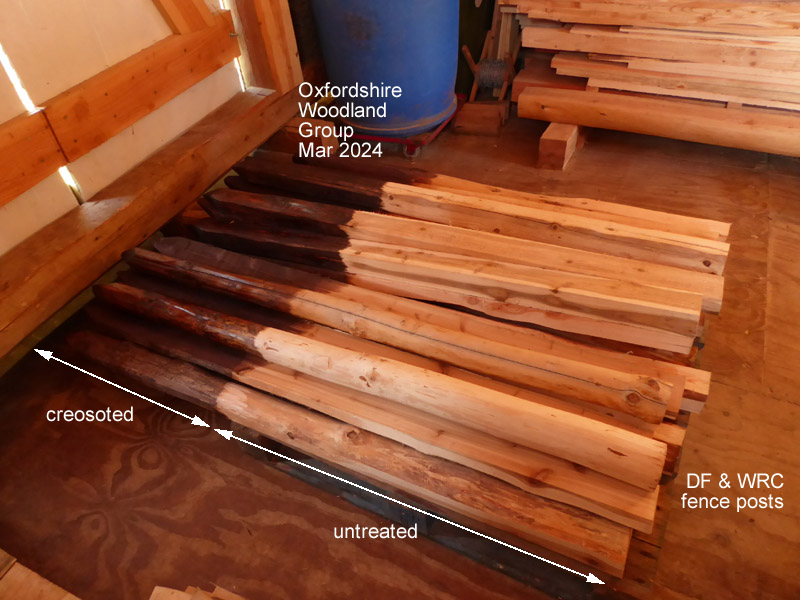

Rather than repeat this eco friendly approach I have decided to trial using home made treated posts where the bottom 2.5 - 3 ft of the posts are soaked and painted with creosote. Creosote is quite a nasty material and is no longer available for the general public to buy in small 1 gallon / 5 litre cans at the garden centre or hardware store for domestic use, however contractors & agricultural / forestry persons engaged in larger scale work can still buy 25 litre drums and use same provided they follow the clear personal health & safety guidelines.
The above ground portion of the fence post does not need to be treated and in any event this part of the post will need to be grasped to hold and drive same into its final position and secure the wire to the posts using staples.
The ends of the fence post (0 - 12") can be stood in an old oil can and allowed to soak up creosote whilst the upper (12" - 36") can be treated using a paint brush. The posts should then be left for several days on top of an old pallet so that any surface creosote is absorbed into the wood.

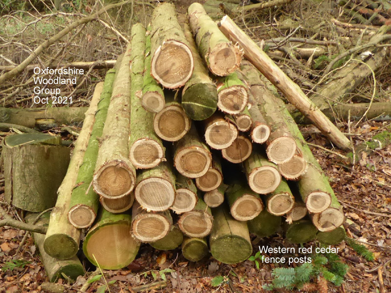

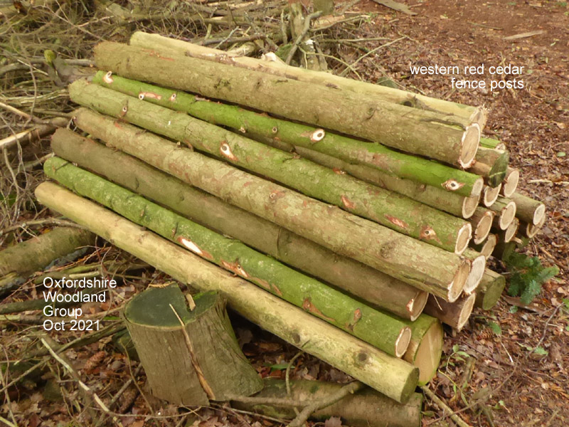

Suppressed western red cedar grows tall and skinny and this can make excellent fence posts.
The heartwood is durable in the ground however the light coloured sapwood is perishable.
After debarking the post bottom ends that will be in direct contact with the ground should be treated with creosote to ensure a long service life.

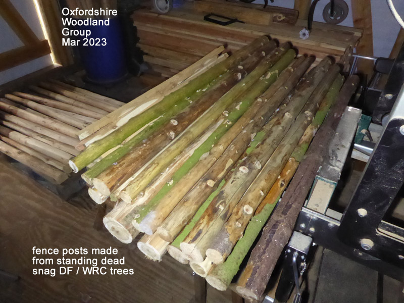

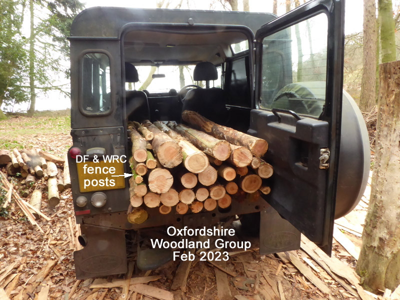

February is a good month to harvest standing dead DF / WRC pole trees to be cut to length to make fence posts and firewood.
Standing dead suppressed conifer trees are ideal for conversion into fence posts.

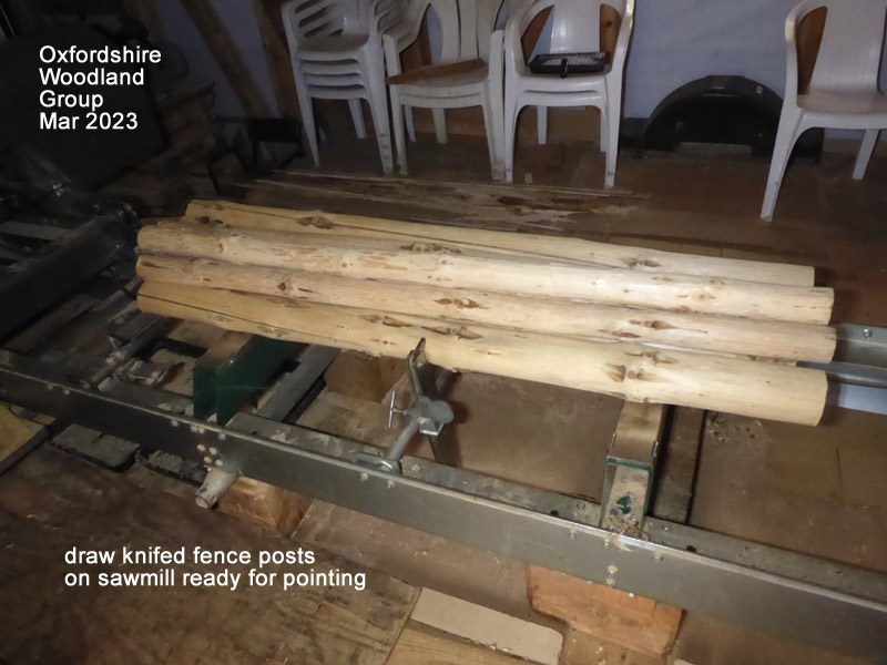

Remove any remaining bark and peel same using a draw knife or spoke shave prior to pointing & application of preservative to the underground section of the post (only).
Creosote is a very effective way of preserving post bottoms in contact with the ground whilst leaving the above ground section in a natural state so that hand contact can be safely made when driving posts and fixing wires.
