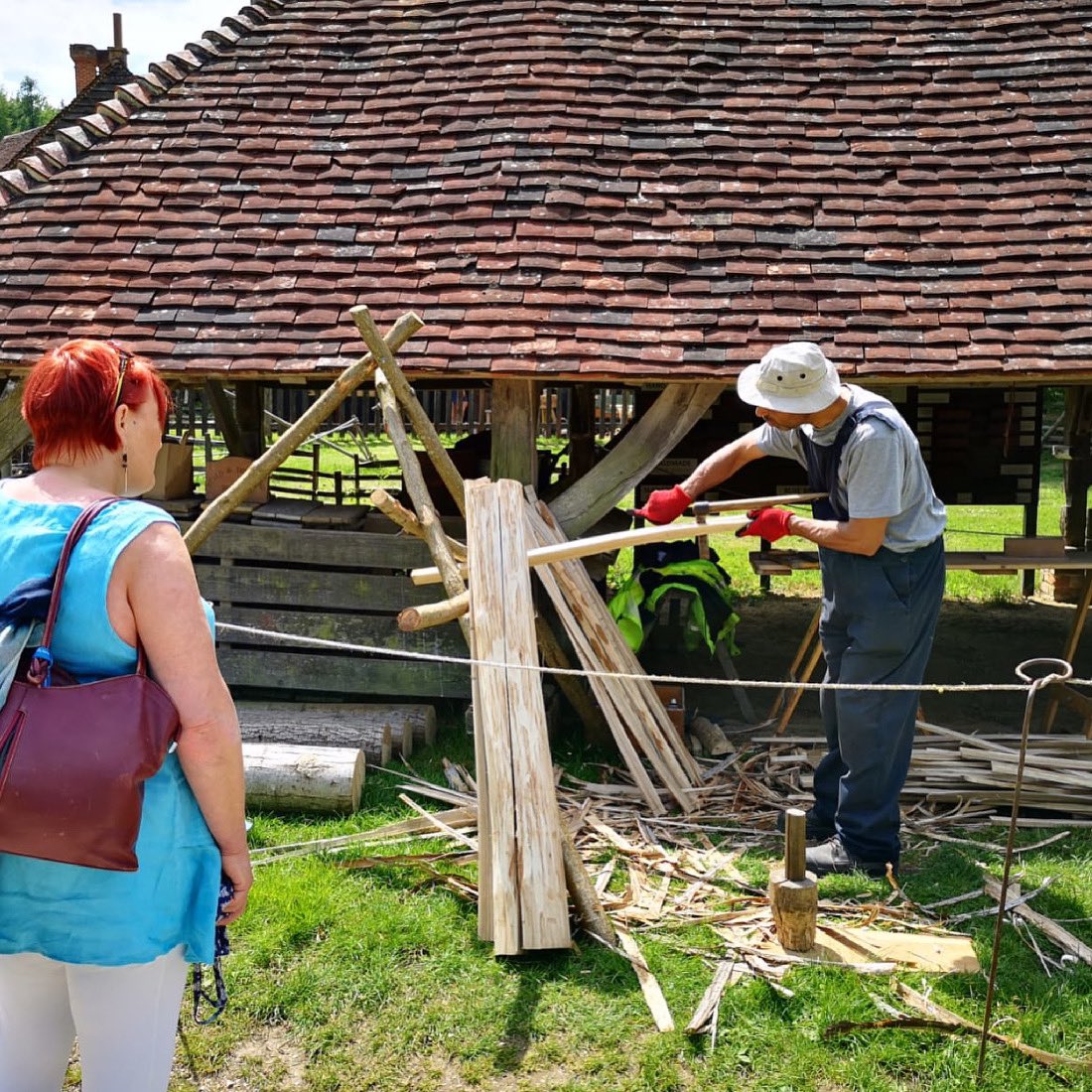

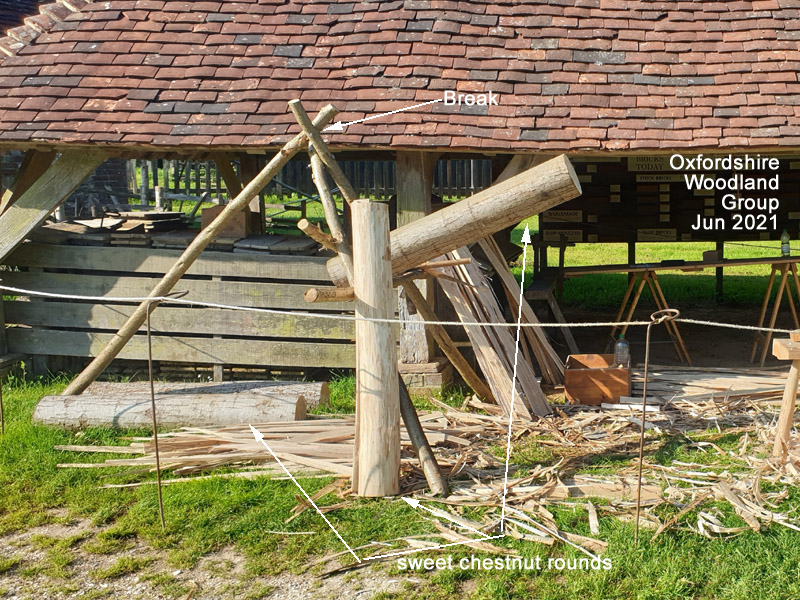

10 years later the lath making process was demonstrated by Herbert Russell at The Weald & Downland Museum. The lath making process involves clamping a short length (4ft) of a sweet chestnut round log in the clamping brake in order to remove the bark.

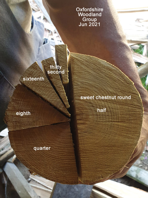

The log is then upended and halved progressively to produce cake slice stock.
The inside heartwood strip is removed following which the resultant thick strip is then cleved and split using a froe in the brake.

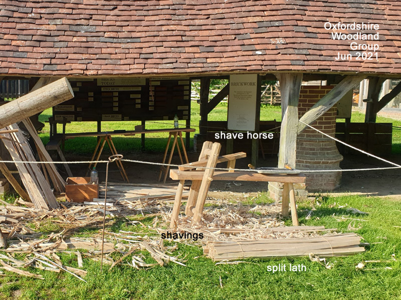

The strips produced are then flatened on the shave horse using a draw knife.

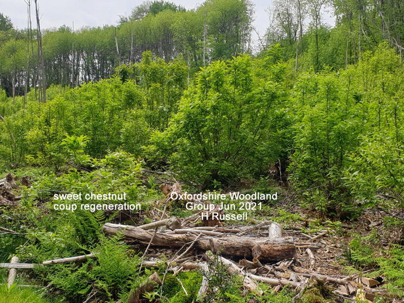

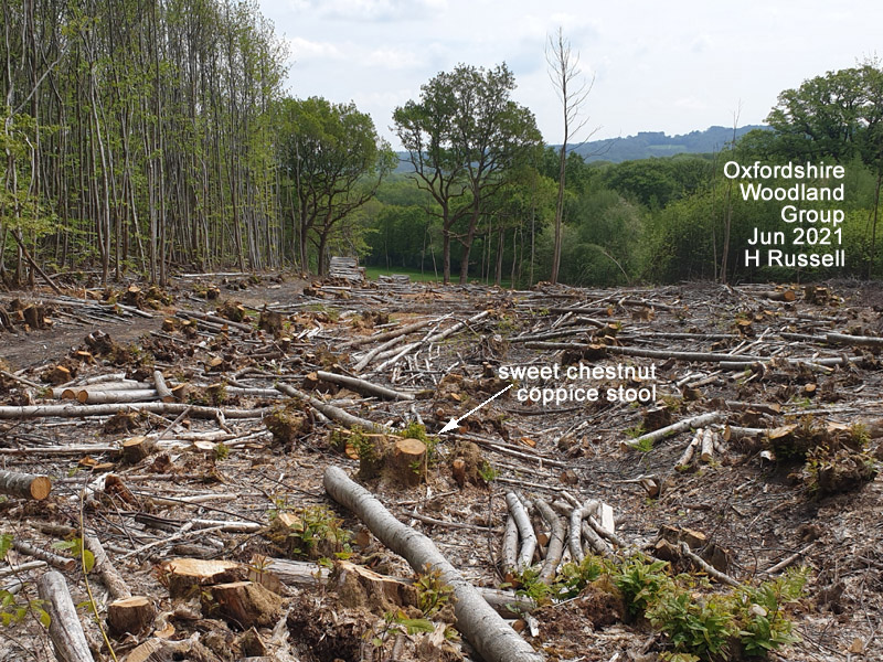

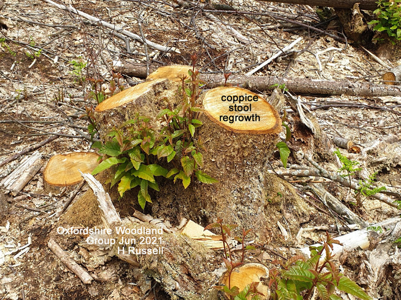

The apocalyptic scene below is of the woodland where the sweet chestnut grew last year.
Already the following spring new shoots are sprouting from the cut coppice stool.
An adjacent previous years sweet chestnut coup is already regenerating at an alarming speed.
