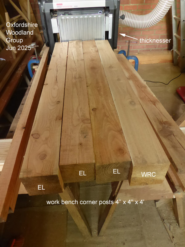

OWG has been awarded a "Shoulder to Shoulder" grant by Mens Sheds and DRINKIQ to produce a work bench for community use in our cruck barn.
OWG Fellow Cora Firth has produced a design and timber list that has been used to resaw seasoned European Larch to make the bench.
The resawn timber is being processed through the thicknesser planer to ease measuring and mark up of joints together with improving aesthetics by highlighting the woodgrain.

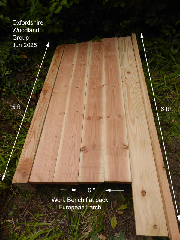

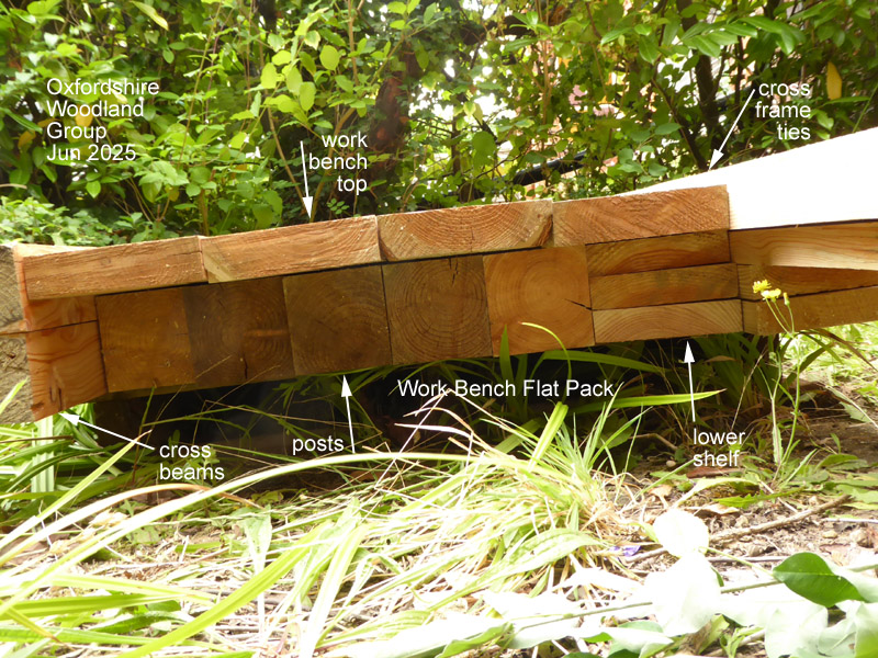

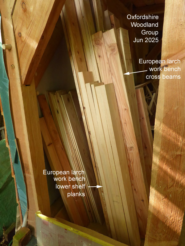

The components needed to make the workbench have all been thickness planed and stacked in flat pack fashion ready for pick up and delivery to Cora Firth's workshop.
4" x 4" posts
4" x 4" worktop under carriage beams
4" x 3" cross frame beams
1.5" x 6" planks for workbench top, cross ties & lower shelf

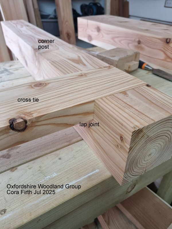

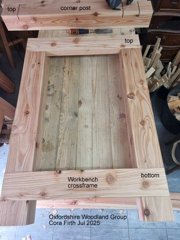

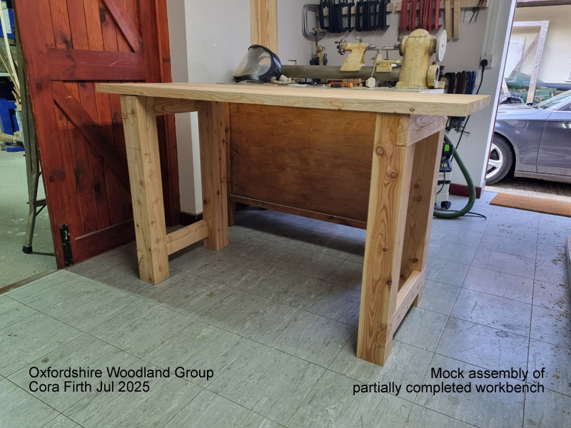

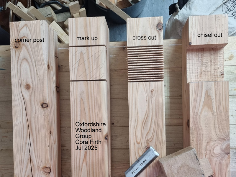

The bench top and cross frames have now been partially completed and stood up in mock assembly format sufficient to obtain an over view of the finished outline of the bench.
The corner posts have has their housings marked out and cut.
The lower cross tie fits into the corner post lap joint ready for glueing and pegging.
A cross frame is trial assembled.

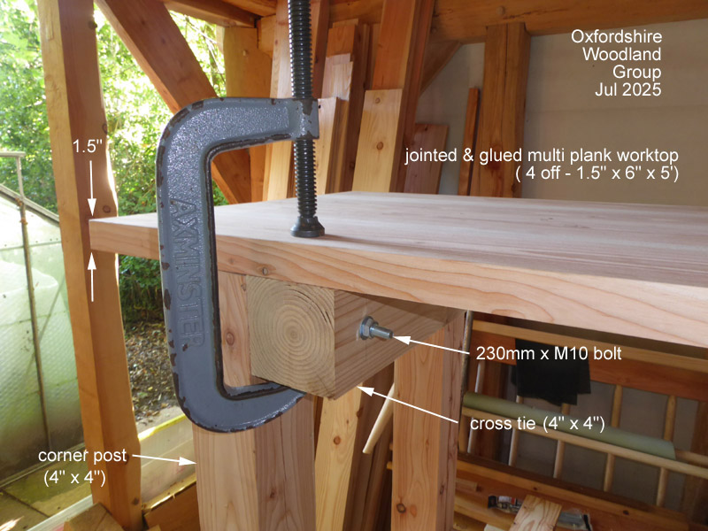

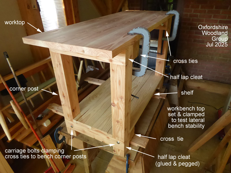

The workbench parts were moved from Cora's workshop to the bodgers shop where the bench was assembled and part bolted. The worktop was then clamped to the cross ties to test the longitudinal stability of the bench. Rock solid !

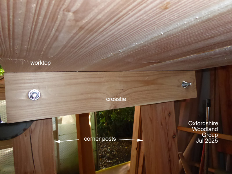

The worktop & lower shelf will now be drilled & bolted to the cross ties which will provide the permanent longitudinal and racking stability.
The underside fit of the worktop to the cross ties was checked to ensure that the joints on the multi plank worktop would not be subject to bending stresses that might result in damage and separation of the glued joints.

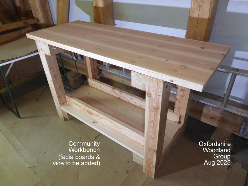

The community workbench has now been moved into position in the OWG cruck barn ready for addition of the fascia boards and wood vice (funding or donations required).

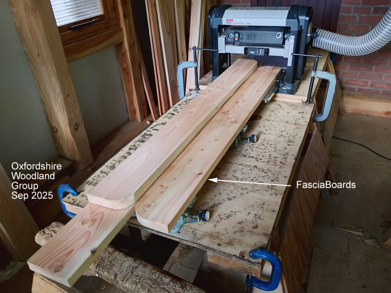

The fascia boards were selected and run through the thicknesser to produced a nice planed finish followed by profiling the ends to remove sharp corners before fitting to the work bench.
A woodworking vice has now been purchased and needs to be fitted to a profiled opening in the front facia board.
