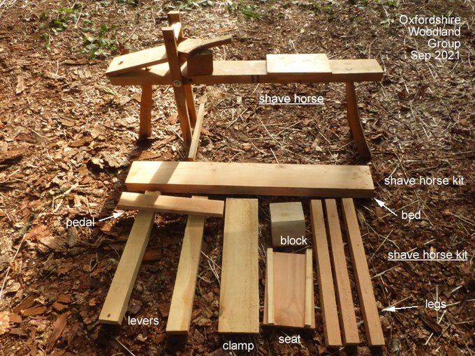

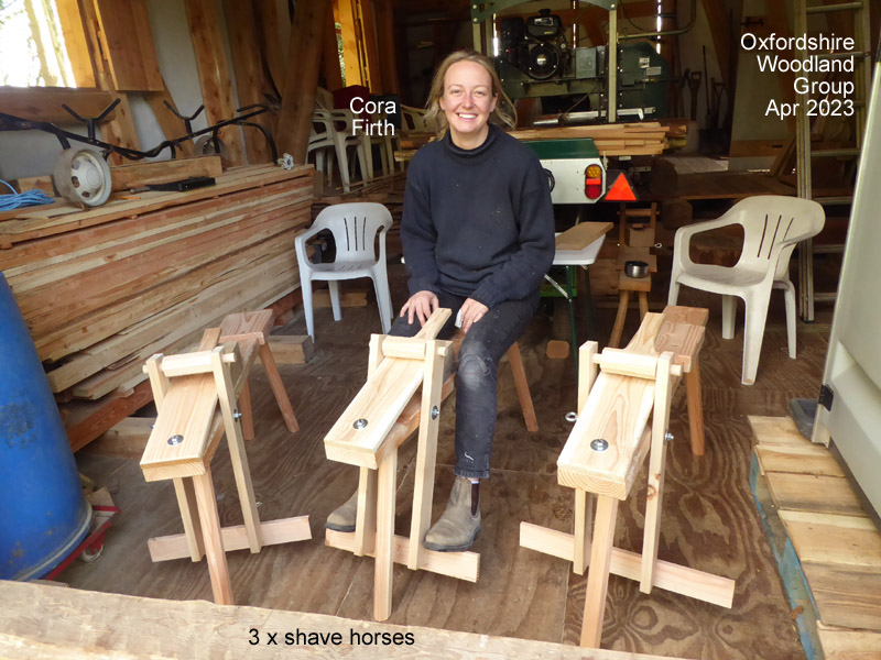

OWG are making a batch of shave horses to support their community based work with Headway UK. We have decided to make these available either as a kit of parts (£50+pp) or fully assembled (£275 ex woodland) for all to enjoy making greenwood items (spoons, chair legs, pegs, etc.)
Cora Firth makes our shave horses which are a delight both to behold and use.
To purchase your own horse please contact Cora or OWG Trustees

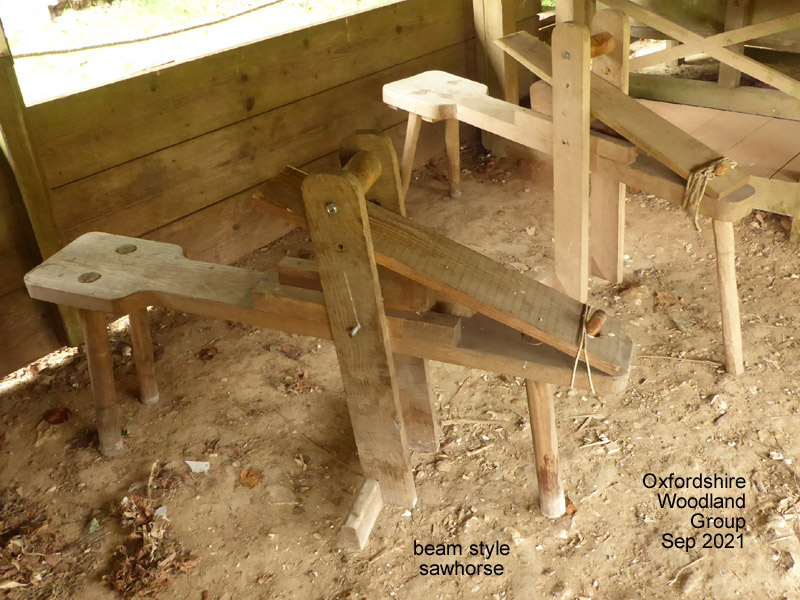

A variant on the OWG plank saw horse is made from wider stock plank material.

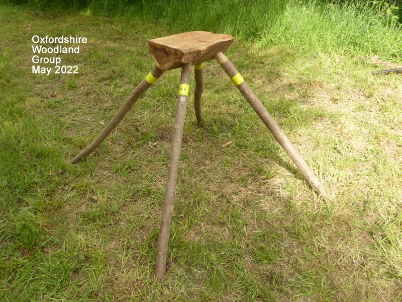

Alternatively, a simple narrow beam can be employed with an attached wide seat featuring tripod legs.

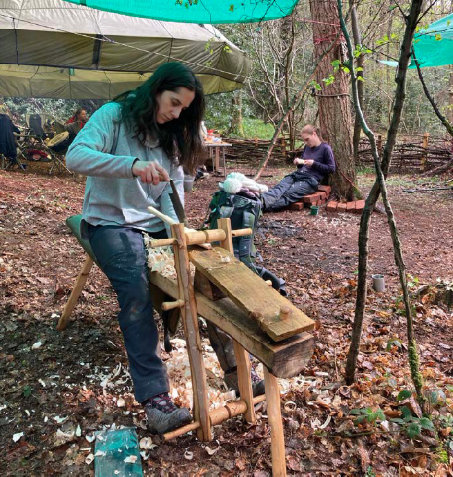

Seen in Living Woods magazine no 60 - summer 2021 a picture of Caroline Bales (Instagram @wishwell_woods ) green wood working shave horse.
This is very similar to the OWG shave horse but makes greater use of turned wood components.

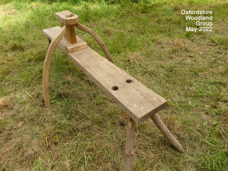

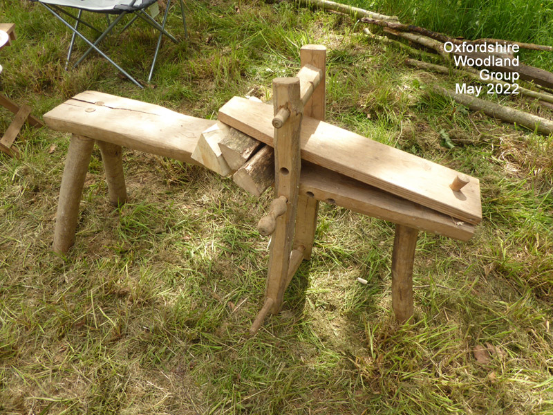

Seen at the Berkshire Bodgers woodland centre near Hungerford
A rather peculiar spoon maker's vice
A spoon makers anvil
A bodgers shave horse
A chair maker's pole lathe.

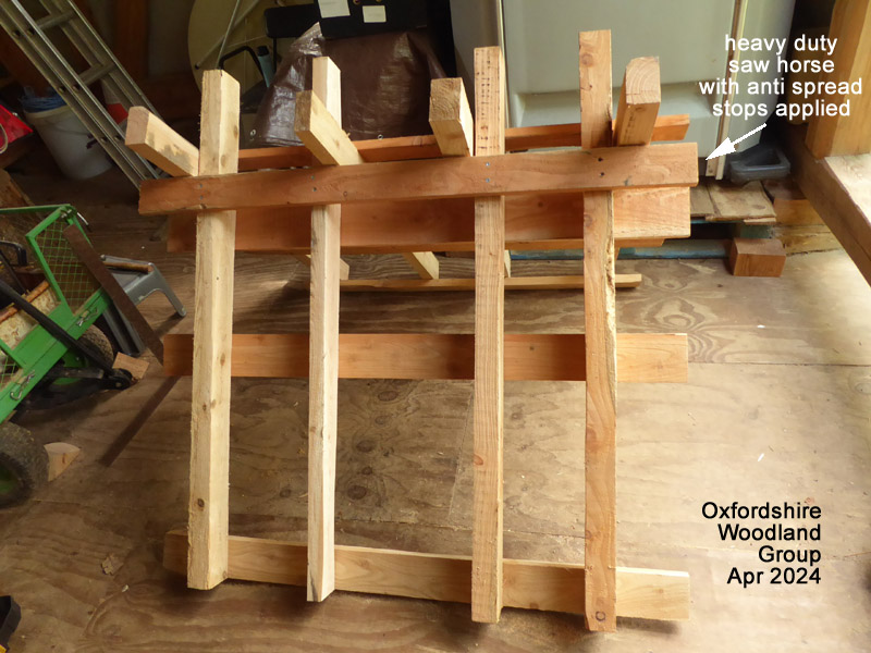

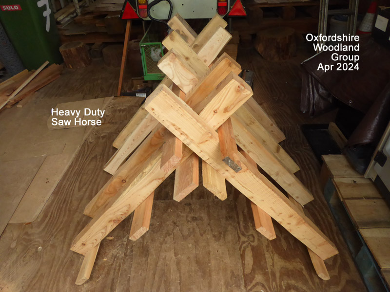

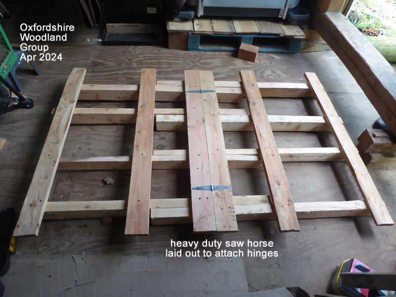

Oxfordshire Woodland Group volunteer Neil Warren made this heavy duty saw horse from larch timbers converted on the Woodland Mills mobile saw.

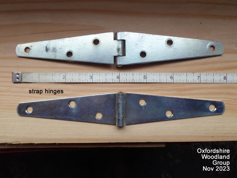

The strap hinges needed are 8" long
The sides frames of the saw horse are then stood up a set at the required operators angle and stop planks are afixed to prevent spread of the horse.
The saw horse was completed by trimming protruding rails on the sawhorse
The sawhorse has now been taken home to process firewood.
